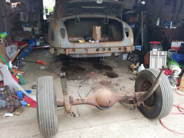

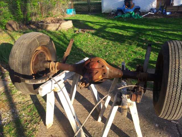

Pulled the rear end out of the 51 hydromatic and have it up on blocks. Would like some advice/recommendations on what to replace on this unit that has not been on the road since 1979. I did drain some of the oil. It was black and had no water/milkshake look/ chunks etc... so no big warning signs besides the obvious leakage.
Obviously the pinion oil washer and differential carrier gasket should I be looking for anything else? Drive shaft oil seals? Wheel bearings?

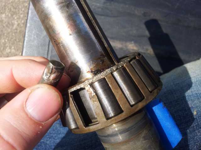

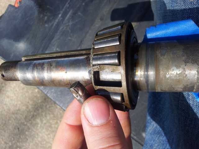

Here is a grenaded 25877t
The other side looks pretty good. I believe the inner oil seals are original to the car. The look a little leaky. The outers were toast.
So does anyone have a 25877t or two that they scored a few years ago when Paul was blowing them out for $30 and wants to make a profit? Or even a serviceable used bearing wouldn't be bad either. HETray.krause@gmail.com drop the HET 🙂
So I obviously need a bearing... should I replace the inner seal? Doug said probably not but is a little leak (the stain) an ok-ish thing?
