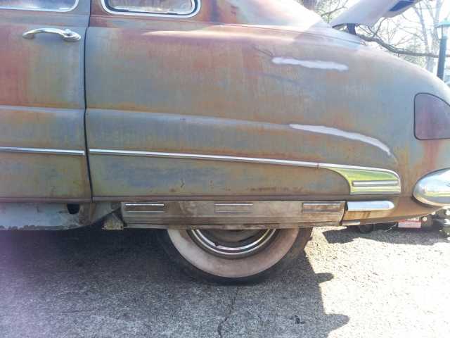

How do I know if the rear leafs have had it? What is the ride height for the rears supposed to be? Is there a way to measure the leafs once its out of the car and without tension? Or is it better to measure while on the car? Also instead of buying new ones my father (who is really old school) said that a metal shop could heat up the leaf pack and then bend them back into shape. Is this still done?

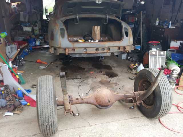

Well.... the rear end is out of the car....
Any way to check when its out?

Raymond, those springs are about 65 years old. My 52 Hornet rear spring were sagging with less than 82,000 miles when I bought it. I liked the look but it would bottom out easily. When I removed them at 53,,000 miles the left rear spring had 5 out of 8 broken leaves. You can see how low it set in aviator picture. I would recommend contacting Russ Maas to buy new rear springs that he sells. You will not have to worry about old springs. Might consider buying new shackle's & bushings, and track bar bushings from Russ at the same time. Since you already have it apart, might as well make it like new.

Doug, my springs were the wrapped type. The wrapping was a challenge removing to see how bad the leaves really were. Each of the five broken leaves had at least two major brakes and around each brake were many many smaller broken pieces. I suppose another indicator of worn spring like mine is that each end of the leaves no longer had nice radius ends and the ends were razor sharp with irregular shaped ends. Only the main and second leaf ends are visible.
Raymond, at the time I didn't have the money for new springs but I had a 54 Hudson parts car with rear springs I hoped would be good enough. They did not raised the rear of my car as much as I hoped but did raise rear one inch at center of wheel but not as high as your car sets.. I just went out to measure height to compare with your photo and your car sets 1/4 inch higher than mine at the same measurement location as your car. Is your measurement with car stripped down? That my account for the difference between our cars ride height. If you chose to reuse your springs, clean and look very carefully at the spring leaves in the middle where they are not covered, for any stress cracks. That area near the wrapping and a short distance under wrapping is where most of my brakes were located as well as at centering bolt hole. "Hudson also recommends rear springs with metal covers be lubricated every 10,000 miles. Lubricate through hole in cover using viscous chassis lubricant, use special tool for that purpose." My springs obviously were not lubed as recommended. I don't know where one would find the special tool or where the lube hole might me. Something else to look for.

Motor, trans, gas tank, front fenders, grill, and hood are off the car. I just pulled one side... probably pull the other side in the next hour or two. Hopefully have a better idea about the springs condition then.

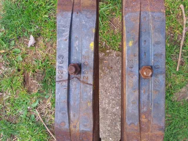

I saw money evaporate. I pulled the springs from the U bolts. Everything looked great. Then I pulled the spring insulators off. And there it was. The ONE cracked leaf.
So now what? New springs? Hope someone has a good single spring that kinda match mine. I called Eaton and these are NOT cheap... I dunno what Randy charges Any insight?

If I remember right, 21st Century's set costs in the neighborhood of $400. Maybe Lee has one good leaf you could use?

The price of the springs Russ mentioned is about right. With shipping to Burbank, Ca. 21st Century quoted me $475 for both springs and shippinjg. I don't recall exact price of springs.
If the metal wrapping was not around the bottom leaf of the spring I have I would give it to you. But with hammer & chisel to get wrapping off to remove the bottom leaf how about $15 + shipping if you want it. The p/n is 302 763 and the other number is 19 0 E.
