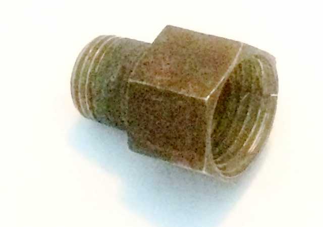

Can someone provide me with the part number for the inlet brass fitting that connects the fuel pump fuel line to the carburetor?

Ken, I have tried numerous times to find this fitting and/or part # in books. Weatherhead makes all kinds of fittings, but I haven't seen that exact fitting. There is one with a 1/8th.pipe thread and 2 , 5/16th's flare nut seats.

Although I've never bought from them, the web site for "Discount Hydraulic Hose" has the tee connection. Their part number is 3752-05-02-05. I hope this helps.

Can someone post a picture of what you are looking for? I found the t-fittings for twin-h at www.zoro.com. They have a lot of stuff that is pretty reasonably priced. Here is that t-fitting: https://www.zoro.com/value-brand-female-tee-brass-brass-18-in-pk10-6ayu6/i/G0877642/

The part number I gave in my earlier post was a tee for the front carb on a Twin-H. I'm not sure if the pipe on your setup has an inverted flare connection but if it does then the correct part number from "Discount Hydraulic Hose" is: 3402-05-02. That is a straight adapter with a male 1/8" pipe thread on one end and a female 5/16" inverted flare connection on the other. Does this sound right?

Ken, I assumed you were talking about for use with Twin-H . The fitting you show is available at any auto parts store acrossed the continent. 1/8 npt male to 5/16th's inverted flare.
