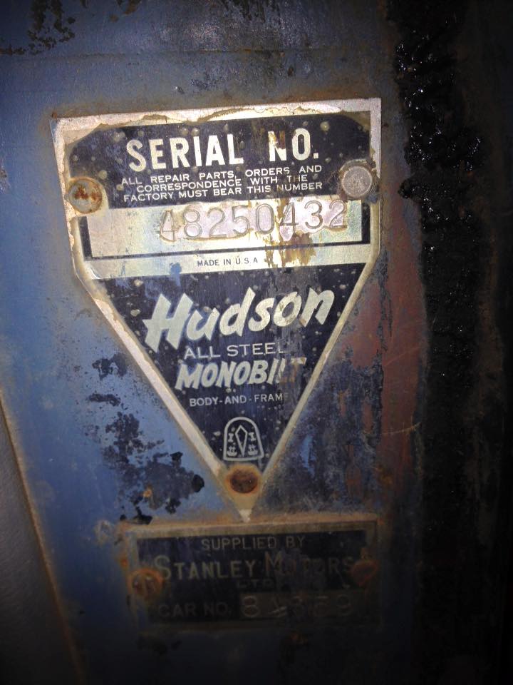

Hi guys, please see below. I finally got my grandfather's Hudson back today and restoration will be start soon (not by me). Can someone please help me identify parts/trim not belonging to the car and more importantly help my identify from the numbers I found inside the door if this is a 1948 or a 1949 model?

Gifford. You ask about removing all the extra pieces that don't belong. You should first do a little research. There are several different years of parts there. The stainless around the back window is from a 52-53, the piece that is above the trunk handle is a '50-'51, I can't see the hood ornament in these pix?. But all these pieces look like they were put there way back, so who owned this car or had this car done like this, would be my question?. The plate below the serial plate looks to be weathered the same?. Was it put there by someone doing a conversion?. These are all questions I would want to know, if it were mine?.
What does the tag below the serial plate say?. This car is a 1948 Commodore 6 "482" and the 50432 is when it was produced. Hudson built about 150,000 that year. Someone here will know the exact production numbers.
