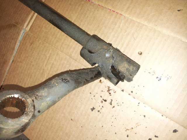

Hey all still making progress on my 51 Hornet but came across a destroyed dust shield/cover where it meets the pitman arm. I don't know if there was a dust shield at the junction with the center pivot arm since the manual does not have much info and there isn't any on it now.
Is there a source for these shields? Is there supposed to be one on the center pivot side?

(@Lance Walker)
Well the dust shield on the picture of the pitman arm and the drag link ought to give you a good idea of their appearance.

(@Richard Dryman)
Those certainly keep out rocks. Would suggest wrapping around the existing shield with self-vulcanizing high voltage rubber tape. At an electric supply house not a hardware store. You can totally encapsulate the joint so nothing can get in it (even water), yet any movement is unhindered. And it holds the grease better.
