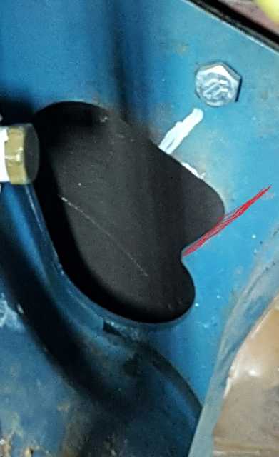

I can't find a clear picture of what the timing pointer looks like on a 262.
Are the timing marks lined up with where I've drawn a red line on this photo or is there some sort of bolt on pointer that lines up where the white line is?
Thanks and regards
Simon

There is a metal tab that is held in place by a bolt in that area. I can see the bolt hole but looks like the tab is missing.
Timing marks are on the flywheel.

Where you have the red line is the motor pointer. Put a dab of white paint on the very end. Then paint the long mark on the flywheel and line it up with the white mark on the motor plate That is top dead center. Put the timing light pick up wire on number one spark plug wire and move distributor to line up marks. Vacuum advance line must be disconnected and engine idling at 500 RPM's. Best to set it at the small mark just before the long mark for today's gas. Walt.
