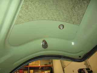

I don't know if the factory pre-cut an access hole in the inner trunk lid but that would be something to look for. It may be necessary to cut one when you install your rocket. This is my 1954 four door sedan trunk lid.

Steven, you didn't mention what year car you had. Those measurements won't work on a '54.

[quote="Russ Chilton" post=14394]Steven, you didn't mention what year car you had. Those measurements won't work on a '54.
Russ, I just reviewed some of Steven's previous posts. He has a 1951 Club Coupe.

Then the measurements I provided should work great.
