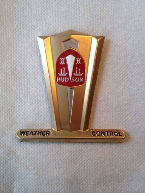

(@Richard Dryman)
Might want to think about doing this when you pull housing off.
Posted : 01/12/2015 8:00 am
(@kholmes)
Posts: 419
Rob, I sure hope I sent you this pic along with the 12v conversion info!
Park
Posted : 01/12/2015 9:04 am
