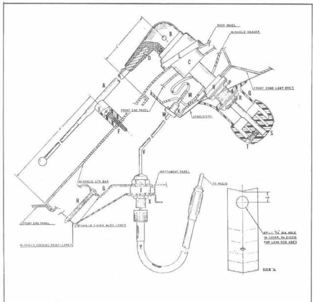

Does anyone have an exploded view picture of the step down antenna they can share? I wan't to make sure I get all the washers, spacers and nuts stacked correctly reinstalling it.

Hi Chris
See the attached and below

This bulletin might help - 1948 - 1953 exc. Jet - Radio Antenna Installation Kit. Go to hetclub.org. You can find a copy in the online library under 1948-1954 Bulletins.

(@hudbob)
Posts: 117
Estimable Member Registered
Ray,
If I remember correctly, you loosen the set screw (T) on the knob and remove the knob (S). You will then see a nut (R) that will tighten everything up. Be careful not to crack the escutcheon (Q).
Hope this helps.
John Forkner
Posted : 19/03/2016 2:20 pm
