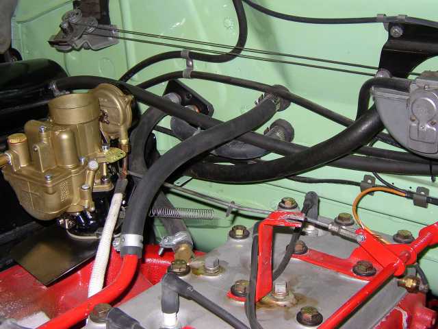

(@hudbob)
Posts: 117
Estimable Member Registered
Here's a picture to verify your hose routing.
Posted : 21/10/2015 5:59 am

 ok54
(@ok54)
Posts: 272
[quote="John Forkner" post=13877]Here's a picture to verify your hose routing.
I just checked my 51 S6 and it's the same as John's.
Posted : 22/10/2015 10:42 am
(@dana-holliday)
Posts: 45
Trusted Member Registered
If I am reading Walts hose routing correct, It is different than the posted pictures. Mine are routed the same as the picture.
Posted : 22/10/2015 12:23 pm

(@Lance Walker)
Ray, The routing of the hoses John Forkner provided is correct. However heat may be coming in due to a punctured ether bladder in the Ranco. You can replace a seal but if the bladder is ruptured, it's no good. Of the many,many of Rancos I have repaired over the years, this happens about 10% of the time I get one to repair. Nothing you can do except get another bladder of get another Ranco altogether.
Posted : 23/10/2015 9:54 am
