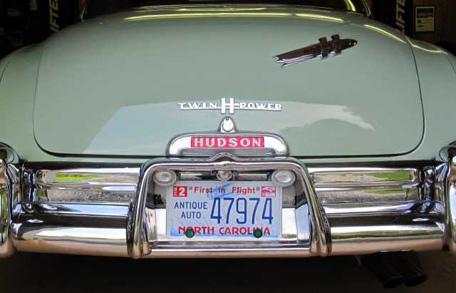

Rob, Unity back up lights were sold by Hudson dealers as an accessory. Guide lights were also used as another type of backup. Yankee was another manufacturer that also supplied these needs and was used back when. They all still appear on ebay ,flea markets and Hudson meets. .

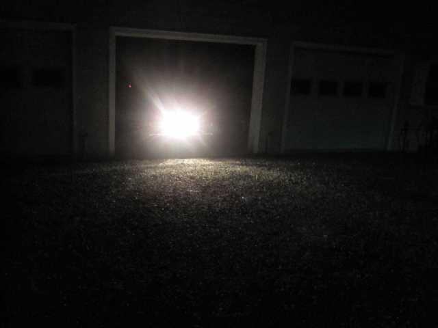

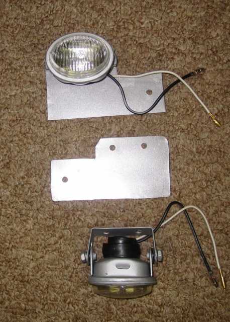

[b][color=#ff0000]UPDATE[/color][/b]>>>> tried to find these at O'Reillys online and they didn't have a listing any more.
HOWEVER, located the correct one at Amazon. Would suggest if anyone even thinks they need these on a 52-53 to get them. They are [b]$14.05 now[/b] and that includes 2-55 watt 12v halogen bulbs. {for 6 volts: you must buy the bulbs
>> http://www.amazon.com/Blazer-RE761C-Radiant-Effects-Halogen/dp/B00KXNRCOG
AND, you can hardly see these compared to the stock ones that fasten to the body >> bad !!
