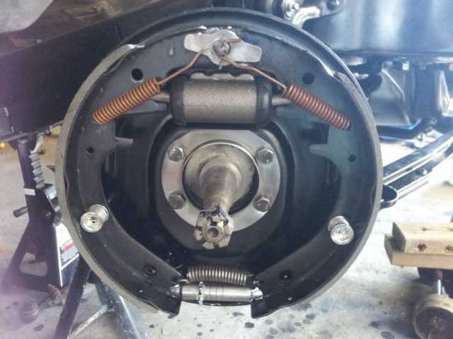

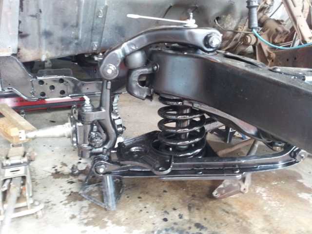

Here is the drivers side front wheel. This will be done next along with the steering box. I did one side at a time to serve as a reference, because even though I have a manual, its better for me to see than to read.

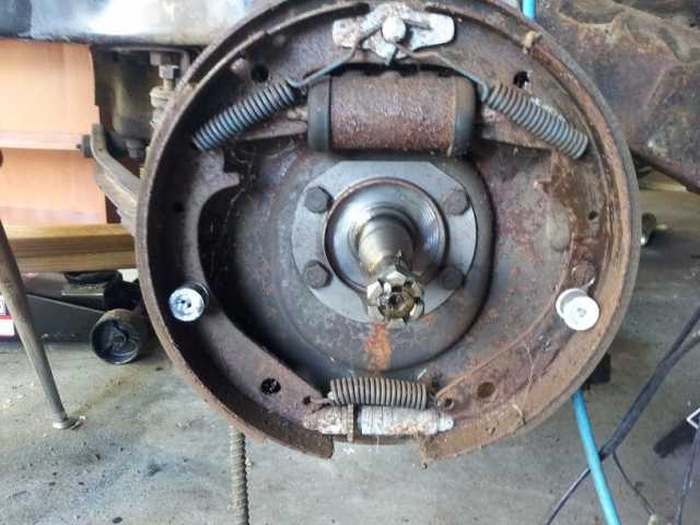

Drivers side before I start on it. Gives you an insight to what I began with.

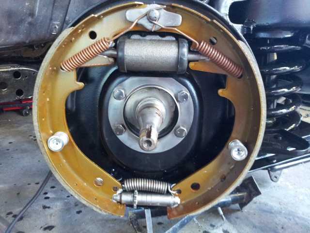

First completed side, wheel, with brake hardware.

Ray, those shoes look wrong. Once you get the drum back on, and adjusted as the book describes, look thru the window located in the outside edge of the drum. You can see your contact points. Get back with that info, curious?.

Good eye... they are the wrong shoes. I was mulling over a mod to the anchor pin in order to use an easier to get shoe instead of the #12. I read about the mod after a search on the open forum. After seeing what would need to be done and how much I could screw it up... I'm going to go with a correct set from Dale. Just seems like less headache, plus Dale is an awesome guy.

New shoes from Dale were on my porch this afternoon. I was a little skeptical at first because they looked so similar to the others, but the way they went on I could just tell that they were a better fit. Some small dimension is different and right on. I popped them on, grabbed a drum and they were perfect. One step forward.

I have to say, Doug, that is a pretty awesome spot! I took a picture of the "before" on my phone so I could compare to the picture of the new ones side by side, and honestly, I noticed very little difference (some, but nothing noteworthy). I know about the Ford shoes and the area around the anchor pin has to be adjusted, but, I'd like to know, what was it that tipped you off that didn't "look right"? Were those Ford shoes?

They were Ford shoes from like '71 to '86, a TS-263 (Napa numbers). Drum went half way on and then nope.... no more.
