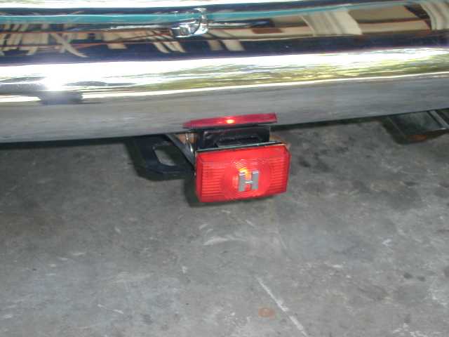

Now you can make a third brake light to plug in the unused receiver. I made mine and put a chrome "H". on it to dress it up.
Posted : 14/09/2015 1:10 am
(@Rob Hesselmann)
David,
Nice light!
Rob
Posted : 14/09/2015 1:11 am
