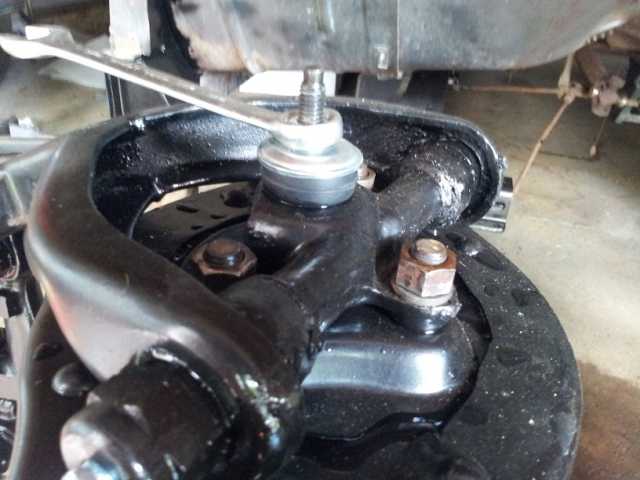

How tight should the top and bottom front shock mount be? What is the rule of thumb? Seems like it can be pulled down real tight or be left somewhat loose.
Thanks!
Ray
Posted : 07/09/2015 1:51 pm
(@David Carpenter)
Tighten until the rubber bulges flush with washer, so they have the same diameter
