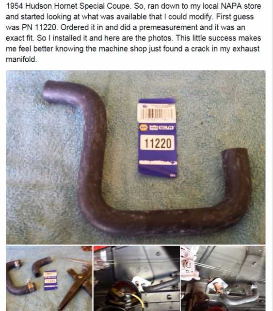

(@Richard Dryman)
Ed Petersen just posted this on HET Facebook-- Things do need to be in one central place? This also fits a '53 and probably earlier.
