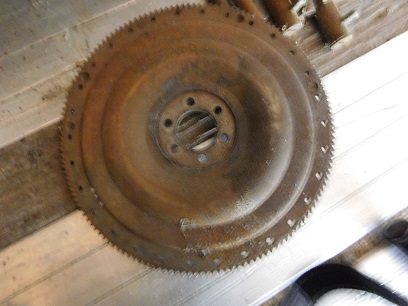

Are there different flywheels for a 308 engine, standard or Hydra-matic?
If so, how does one identify them?
I got one at the swap meet; looks like NOS. but not sure if it will fit my car. Price was too good to pass up...
Rob

They are different. Yours looks to be a hydramatic. I bet it has two dowels on the other side to engage the torus cover

(@Rob Hesselmann)
David,
Thank you.
Yes, it has two dowels.
Rob

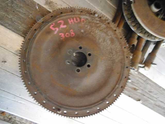

Rob, these pictures are from a 1952 308 with hydramatic. Appears the same as yours.

(@jomoali)
Posts: 429
Rob,
A standard shift flywheel is completely flat, so this is for a hydramatic. The only possible difference could be between the larger Hudsons and the Jet. I don't know if they are the same.

(@holden)
Posts: 478
Honorable Member Registered
Hydra-matic flywheels were made as one unit (integral ring gear) and engaged from the front of car. Standard flywheels (as mentioned) were flat and had pressed on ring gears which were engaged from the rear of the car. You have the correct flywheel.

(@dlm31)
Posts: 960
Noble Member Registered
A stick shift flywheel has only 16 bolt holes. A Hydramatic has about 30, both have dowels that are in place 180 degrees from each other. There are distinct differences in both flywheels for when applied to the '55-'56 engines. The auto flywheel for the '55-6 has 3/8-24 threads, '51-'54 is 5/16-24. This also makes the torus bowl different and will not interchange. The torus bowl is deeper on '55-'56 transmission. I have found to use the '55-'56 flywheel and engine in your step-down, you need to have a spacer between the crankshaft,and drill all the torus bowl holes out to 3/8th's. I think this has all been talked about before?. The dowels for both flywheels are in the same place and same size.
