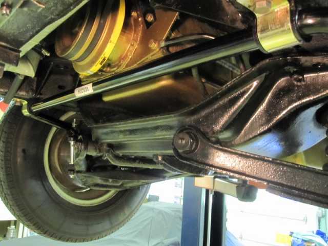

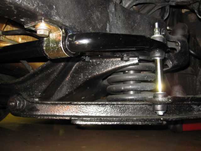

[size=3][b]ADDCO 1.125” bar & links installed. Replaces stock 3/4” bar & links. Cross section area of new bar is 2.25 times area of stock bar. Poly bushings & powder coated solid steel. Thanks to all who helped with this un-official club project; 15 bar kits were made.
Bottom photo is with wheels totally down; bar basically parallel with surface the way it should be.
Fun to drive now !!!!!![/b][/size]
