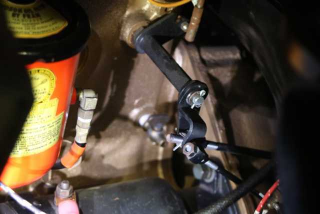

Not a very good pic, but you can also put a petcock in there and make it a snap to drain it directly into a container (with a rubber hose).

Thanks for all the help. The picture was especially helpful. Unfortunately I now remember why I haven't drained the block for a while. The drain plug is frozen up solid. I wasn't in the mood to go through the agony of trying to get it out. Instead I took the lazy man's way. and just opened up the radiator hoses and ran the garden hose through the radiator and into the block at the top. It probably wasn't the best job but the water looked pretty clean when I stopped running the hose.
