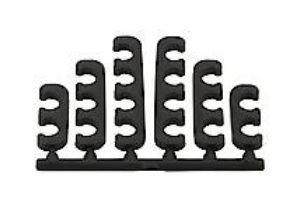

If one wire has a lot more resistance than the others , you need a new wire or a new set. Resistance per foot should be about the same on all the wires. Keep wires away from metal and each other as much as possible. Use the cheap separators as needed; and use best wire you can rationalize.
