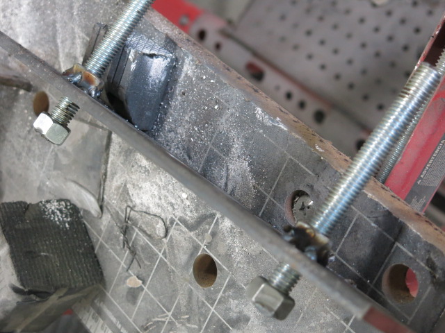

Have pulled the drum and all the good stuff off my 37 Hudson terraplane rear axel but don't see how to get to the bearing. The Back plate seems to have two large rivets holding it on even when the four bolts are removed. Any suggestion and guidance would be appreciated.
Posted : 04/07/2015 1:28 pm
(@kholmes)
Posts: 419

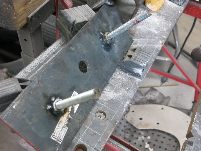

You don't need to do anything with the backing plate. Bearing is a slight press fit into the axle housing, so pulling the axle (with bearing) is your next step. I assume you've already got the axle/bearing retainer cap already removed (4 nuts). Here's a puller I improvised, with a piece of 3/8" plate and a couple of 1/2" Grade 8 bolts and nuts. Running the nuts out on the bolts puts outward pressure on the plate. Works pretty well.

Just finished making the axle puller and it worked like a charm! Thanks!

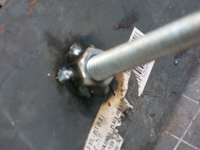

Made the axle puller with some small modifications. Works perfect and with the nuts spot welded the bolts don't wander as much and a ratchet makes tightlng easier. Thanks for the great idea.
