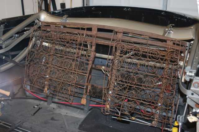

Just make one! Actually, this has been in the works for some time now, but just about finished up the springs for the seat back today. Thanks go out to Michael Whitely and Rob Fayette, and Bill Spelic for the great pics and dimensions. Just a little more to go on the back and then I will be taking this to the trimmer's this week. Tomorrow I'll get the seat bottom laid out. For the seat back, I had about 1/2 of a seat back from a junior convertible (Junior cars do not have the center arm rest). The bottom half was rotted away, like someone set it acid 1/2 way up the seat back. It was only about a foot tall when I started. I had some extra sedan springs that loaned parts and pieces for the seat back and seat bottom.
Really interesting learning how the springs are made and put together. No wonder we only use foam these days, so much easier than messing with the springs. But, it's mostly like an original would be and there's some satisfaction in that. I still have to cut down the sedan center arm rest springs to fit the smaller convertible arm rest.

Springs add an extra dimension foam just doesn't have.
Are you going to use a foam layer over the springs after the burlap?
All the cars I've sat in that have both are far, far better than springs and batting alone!
If you have any springs from the less used edges/sides of the seats you salvaged, let me know, I'd like to buy some.
I have a low spot in mine that needs attention.
