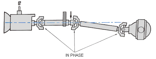

While on the lift a couple days ago for its first inspection, we found the drive shaft center cushioning assembly slightly loose. the rubber was in good shape, but the bracket was allowing the drive shaft a little side to side play. Correcting that problem reduced the rough running feeling [i]a little bit[/i] while driving. (could be the tires, etc. too)
We noticed that the two piece drive shaft is not aligned so that the yokes are all in the same position.
Would this cause a drive line vibration?
Here is a picture to show what I mean;
[img] [/img]

The exhaust is original style. The front and rear drive shaft appear to be out of phase. Yes a drive shaft out of phase can cause vibration.

Lee what do you mean "front and rear drive shaft appear to be out of phase"? Is that the same as out of balance?

There is a splined slip coupling on the back end of the front shaft. Hidden by the cross member in the picture.It can be taken apart and realigned. That can cause vibration at speed. Not at idle though.

Richard and David, thanks, we will get the drive shaft back to the way it is supposed to be.
