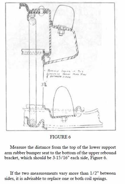

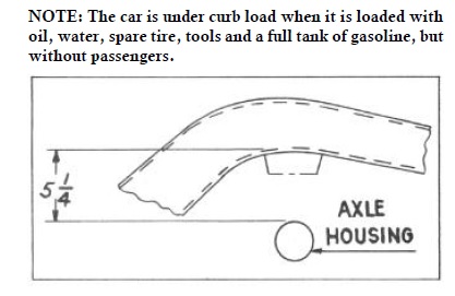

Does any one have the stock height specs for a Hollywood?
I'm trying to determine how much sag I may have in the front coil springs, and rear leaf springs.
Thanks
Rob
Posted : 10/06/2015 11:33 pm
(@Richard Dryman)
In chap. 12 of shop manual. {Pretty Car !!}
Richard
assume Hollywood is like all the rest; no difference that I can find
