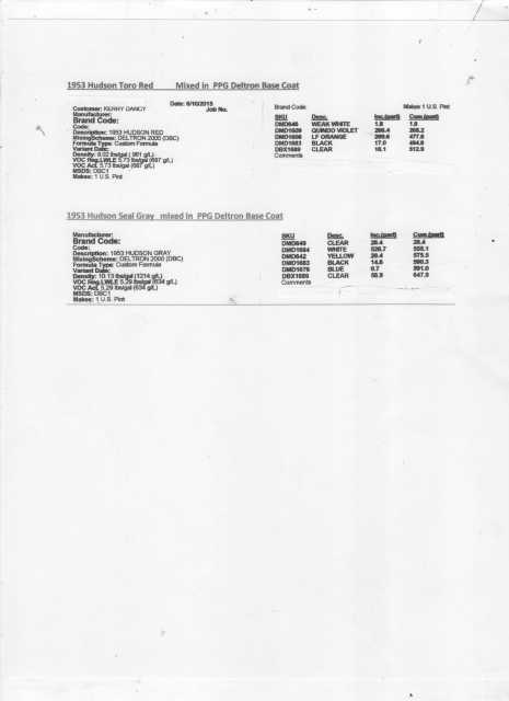

Just got these from PPG. This is in Deltron BC.

There's also a 1941-1954 Ditzler paint chart in the online library - look under 1948-1954 Reference Sheets

Alex, those Ditzler charts give you a start, converting them into modern paint codes is a different animal. I think Ditzler became PPG later on. Any PPG paint dealer could mix those two colors in today's paint using those formulas.
Might be somthing that could be filed in the Library? Modern paint codes for the old hudson colors?
