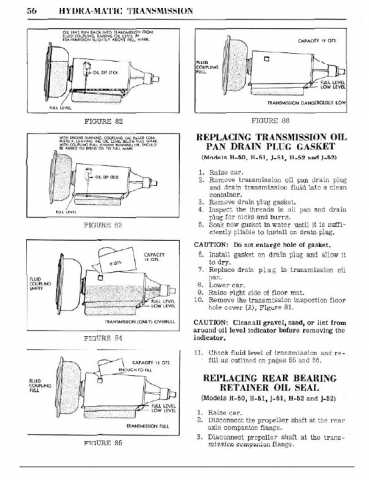

go to "library" and to Alex's literature; '48-'54 Literature,'48-'54 Manuals, page 2, '50-'52 Hydra-matic service manual; page 56 etc
