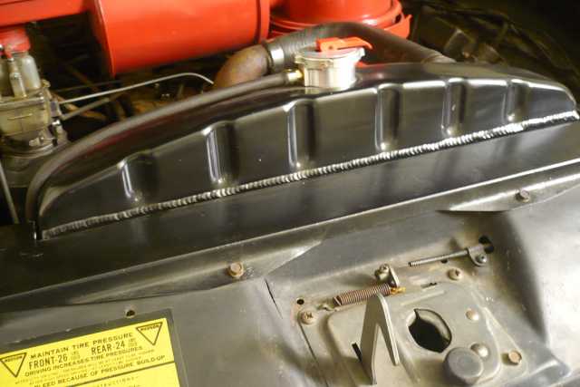

Not to beat this subject to death, but.......
I wanted to replace my '51 radiator due to the aforementioned issues (it showed signs of several previous repairs at the subject areas) so I sought an Aluminum unit but couldn't find anything less than a custom built, very expensive one. I looked at many but decided on one spec'd for '55-'59 Chev pick-up with some mods to make it fit the Hudson. I specified that the 1-1/2 inlet be placed at 6 inches left of center (toward driver's side) and that the 1-3/4 outlet be modified with a 80 degree, upward angled fitting.
I chose this particular mfgr. because they form the top tank with ribs that mimic the original tank's appearance, however, they are cosmetic and not necessary for stiffness. It came with a 1.1 bar cap which I replaced with a 7 lb. cap. (~.5 bar).
Although not a direct fit, it was a fairly simple job to adapt it to the Hudson radiator support. Cost was ~$500 total.
