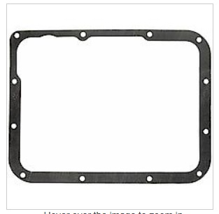

(@Jason Jellis)
Hello,
I got it at my local auto parts store. I'm not sure if it was Advanced Auto or Auto Zone.
They had to order it but only took 2 days, which I was surprised of. So far everything looks correct. I'm going to install it tomorrow.
Then I will know for sure. 🙂
Thanks for the info.
Jason

(@Jason Jellis)
Hello,
I got the trans pan gasket on and it fit nicely.
It is a Fel-Pro TOS 18024
Now I will watch for any leaks. 🙂
Posted : 03/05/2015 8:32 am
(@Richard Dryman)
Thanks, Jason, & Walt. Now I will purge my cork gasket !!!
Here is what the Advance Auto selection said when clicking on it:
Felpro #TOS 18024
" This part is an Exact fit for your1953 Hudson Hornet
•12-bolt holes; GMC Hydra-matic; 2 Speed"
$9.59
[b][color=#ff0000]BTY: WHAT IS THE BEST FLUID TO USE FOR THESE TRANSMISSIONS ??? TKS~[/color][/b]
Posted : 03/05/2015 10:01 am
