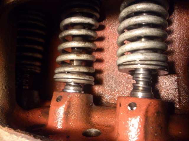

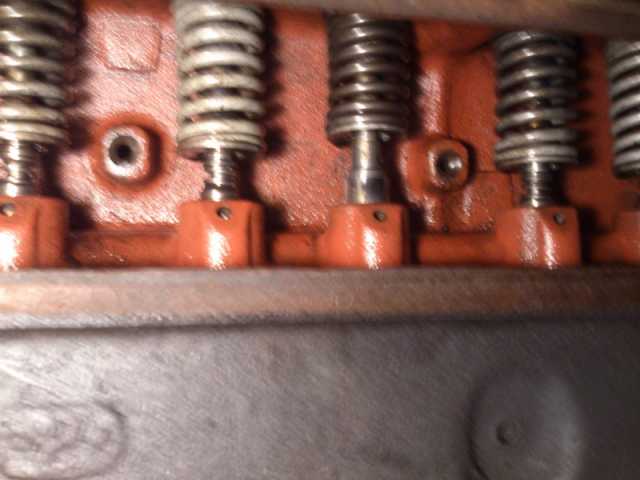

Upon looking closely at the hydraulic lifters, something seemed to a miss on two of them. One seemed to be missing a spring, and the other seemed squished. More on that in a lil bit.

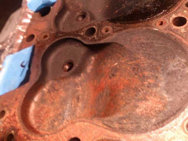

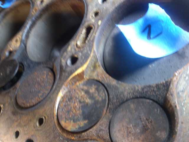

I then pulled the head. A previous "owner/mechanic" had used form-a-gasket under the bolt heads and around the water return goose neck and in areas on the actual head gasket. The bolts came out without incident, but upon removing the head I found a number of potential problems.

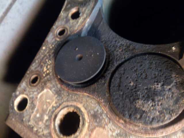

Cylinder 6 had an exhaust valve replaced in its past. The intake valve and surrounding area was pitted.

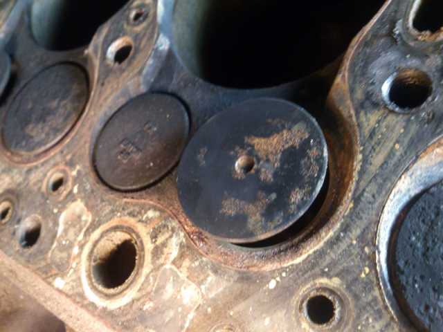

Cylinder 5 had an intake valve replaced in the past and exhibited water damage extending from the gasket line nearest it.

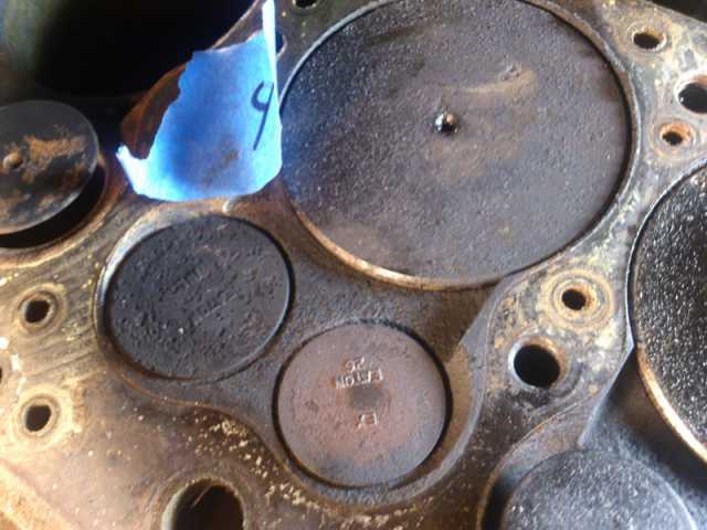

Cylinder 4 had an oil sheen on the surfaces and exhibited some carbon build up/pits. Oil on the head on the exhaust side near the spark hole.

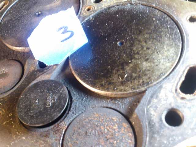

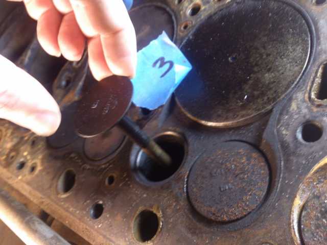

Cylinder 3.... oil everywhere including on the head itself. Exhaust valve had obviously lost its keeper as I was able to grab it and pull it out. The valve guides were still intact and the valve was not bent. This valve corresponds to the lifter that seemed squished.

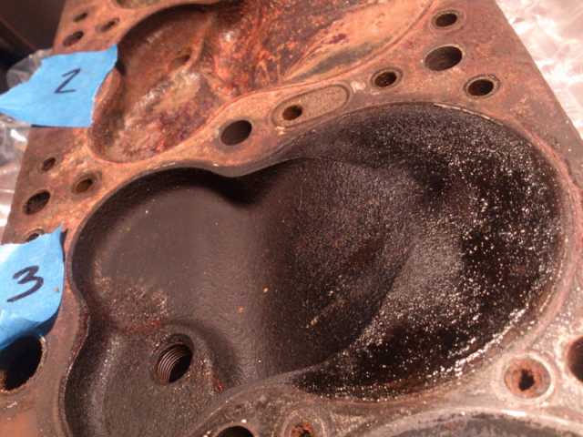

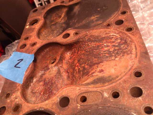

Cylinder 2 has some rust that seemed to come from the side closest to the intake valve. This corresponded to obvious water trails on the head.
Cylinder 1... kinda boring compared to the rest.
No obvious damage to the head gasket at all. In fact to my laymans eyes it looks to not have properly installed or torqued down. Seemed to be seepage of water and oil between areas not through areas but between the gasket and surfaces.

1. Obviously the exhaust valve on C3 needs a keeper or more. In the correct manual there is hardly any info. Anyone with some insight?
2. The hydraulic lifter on the intake of C5 seems to be missing the small spring? Is this necessary?

(@Raymund Krause)
Cylinder 6
Cylinder 5
Posted : 29/04/2015 2:05 pm
(@Raymund Krause)
Cylinder 6
Cylinder 5
Cylinder 4
Posted : 29/04/2015 2:13 pm
(@Raymund Krause)
Cylinder 3
Posted : 29/04/2015 2:15 pm
(@Raymund Krause)
Cylinder 3 Valve Cover
Cylinder 2
Posted : 29/04/2015 2:16 pm

The "squished" hydraulic lifter is collapsed....usually due to dirt getting under the check valve and holding it open allowing the plunger to "bleed down". The valve that had no keepers was getting "HAMMERED" by the lifter, and this probably broke the plunger spring. Yes, you do need the plunger spring. The hydraulic lifters in the 1956 blocks are vulnerable to dirt due to the fact these older motors do not have full flow oil filtration. If the oil was changed frequently, the hydraulic lifters had better chances of avoiding collapse. If you decide to do a valve job and have new mechanical lifters installed, then you will need to replace the "zero lash" hydraulic cam with a mechanical cam. Doug W can tell you more.
