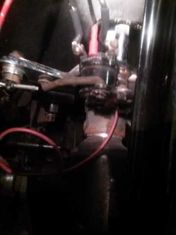

Russ, pictures would be extremely helpful if it's not too much trouble. If I understand your instructions the neutral safety switch is placed in circuit # 14 between the ign. switch & the starter solenoid. My neutral safety switch has 2 screw type connectors then between those connectors are 2 male bullet type connectors. Do I use the 2 screw type connectors or the bullet type? Then to my original question which of the neutral safety switch connectors do I use for the shift indicator light?

(@holden)
Posts: 478
Honorable Member Registered
Hard to get a good pic, but the two terminals with the screws are the ones that go to the starter solenoid and to your starter terminal on your ignition.
