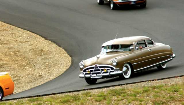

I agree with your opinion of the appearance. Properly installed, they add a bit of a nasty, aggressive element to the already great styling of the S/Ds. It's all in the angle. I see some tilted back which doesn't work for me.
I have one on our Hornet Coupe and have never heard any wind noise attributable to it, in fact, we can drive at 60, windows open, and carry on a conversation at ordinary voice levels......maybe that's 'cause we yell at each other anyway. I've always found that to be very interesting and wonder if it's by design or just a positive unintentional trait.

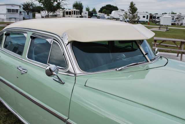

I have one on my 53 coupe for 143,000 miles so far, 17 trips ocean to ocean and over 100 MPH at times and have never touched it. You must have the correct angle and space between it and roof for air to escape. I starting installing the visors in the 50's in my business and learned from customers, an adjustment here and there. One secret is to put an aluminum strip 1/4 inch wide and 4 inches long in the rain gutter to tighten the screws against. Walt.
