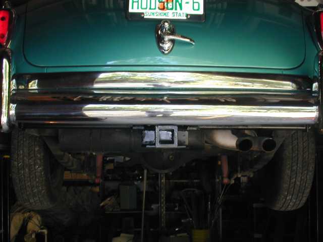

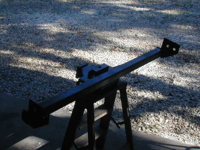

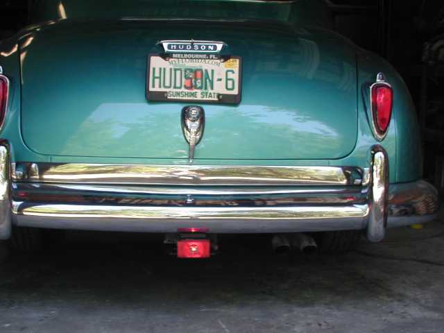

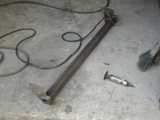

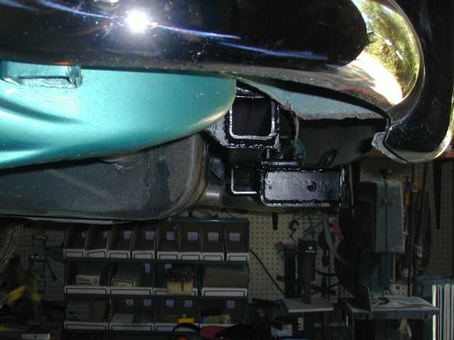

I built one for my 49 sedan. I used a universal square tube receiver welded to a couple of end plates made of 1/4" steel plate. I welded them to the rear unibody frame members. I also welded a tab in the center and bolted it to the body. DO NOT try anything attached to the bumper only. It will rip the sheet metal mounts off the body. I'll try to find some pictures. At present Carbonite is restoring everything due to a hard drive melt down.

Here are a few pictures of the receiver setup we made, if it helps you or someone in your club.
Rob
[IMG] [/IMG]
[IMG] [/IMG]
[IMG] [/IMG]
