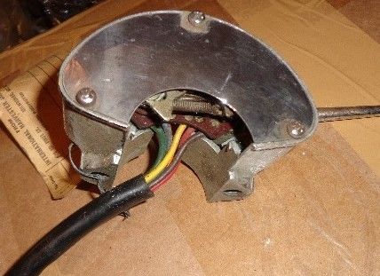

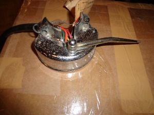

my Hudson came without the turn signal lever and the switch box at the steering column.
I did acquire that part, but it came without the upper half circle bracket (I suppose there is such a bracket).
To be able to install that correctly I will have to make such an upper bracket myself, I do need a picture or even better some dimensions etc.
Here is a picture of such a turn signal assembly I bought:
[ebay]181503920855[/ebay]
[url= http://www.ebay.de/itm/181503920855?_trksid=p2060353.m1438.l2648&ssPageName=STRK%3AMEBIDX%3AIT ]link to ebay[/url]
I would also be happy to get a picture of the end plastic part that is screwed on the end of the lever.
Does anyone have such a plastic ball that he does not need anymore?
Many thanks in advance !
Dirk

You already have the upper bracket. Simply remove the lower piece from the shift lever bracket, and the signal attaches there to.

You should have the clamp on your car, if you have a gearshift.. The clamp is now held to a mating half-circular clamp by two bolts. They sandwich the steering column between them. (If your car has an automatic transmission, the top clamp will look different but I believe it will be fastened to the lower clamp in the same way.)
The lower clamp should now be removed, and replaced with the turn signal switch. Then replace the two bolts to fasten the clamp and switch together.
I am not sure what "cancels" your turn signal switch, returning the signal lever to its "rest" position after the turn has been made. Possibly two pins will need to be attached to the underside of your steering wheel, which will contact two small levers protruding from the turn signal switch. If so, it may be necessary to make a small hole in the steering column so that the small levers on the switch, will extend into the steering column. (I do not have a Step-Down).

Please note what Walt Mordenti just said: you must cut a small slot in the steering column outer jacket (tube), so that the "trigger fingers" on the turn signal switch will extend through the jacket, and be activated by the revolving pins on the underside of the steering wheel. You will not have a pattern or template for this slot, so you will have to carefully position the switch and see where the fingers are, in order to precisely cut your slot.
Please note: there were TWO styles of turn signal switch. They are both identical, but the number of wires is different. One has 3 wires. One has 6 wires. The switch with 6 wires is meant for cars with only ONE bulb in each taillight. The bright filament in each lamp must then serve two purposes: brake light and turn signal light. The 6-wire switch accomplishes this task.
The 3-wire switch is for cars which have TWO bulbs in each taillight. One bulb is a dual-filament: bright filament for brake, other filament for taillight at night. The other bulb is only for the turn signal.
On your turn signal switch, you will need to run the wires down your steering column jacket and up under the dashboard. Hudson had some hardware for this purpose. If you look carefully at either of these two photographs you will see a small steel channel running below the column, starting at the back of the turn sign switch, and ending at a special clamp that holds the column to the dashboard. The clamp (it is special for the turn signal) holds the other end of the steel channel and is shaped so that the wires will pass from the channel, up under the dashboard, without being seen. Often, Hudson vendors will have these items (used) but you will have to send out e-mails and ask them. Otherwise, you will have to tape the wires to your steering column which is not very authentic looking.

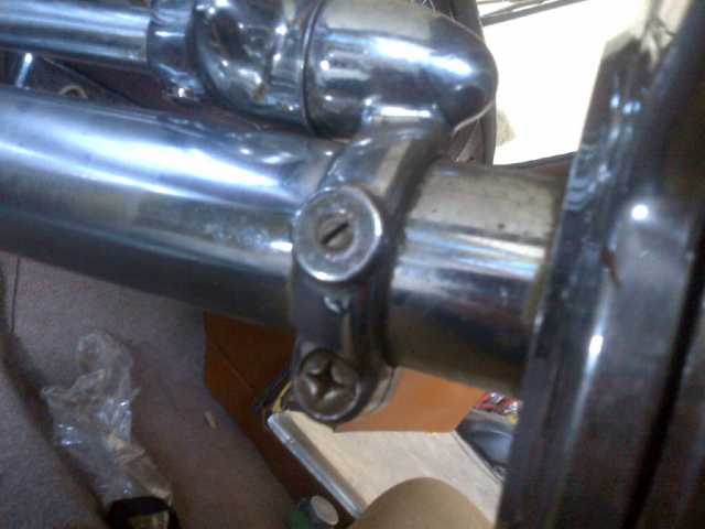

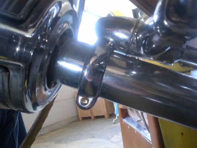

So this weekend I had time to take care of my Hudson. unfortunately the comments above do not match what I find on my steering column. The existing clamp for the gear shift lever looks different. there is no lower part that I can remove and replace with the turn signal housing.
Attached the pictures from my clamp.

This seems strange to me, but there must be an explanation. Unfortunately I do not own a 1948-54 Hudson, but a 1937. So I can only hope that someone "in the know" will jump into the conversation and explain the situation!
In the 1948-49 Hudson Shop Manual there is an excellent drawing which shows the installation of the turn signal switch, in the Electrical Section 6, page 31. The drawing is "diagram 3, figure 25". This appears to show that the switch has it's own bracket which holds the upper part of the gearshift. But it is hard to read the drawing because it does not have a good resolution. You can download this Shop Manual from the H-E-T website but I am afraid you will have the same problem reading it as I did!
So...there would SEEM to be a special casting which bolt to the switch, and holds the top part of the gearshift lever shaft. The existing gearshift top bracket is then removed, and this special bracket takes its place. At least that is what it looks like to me!
