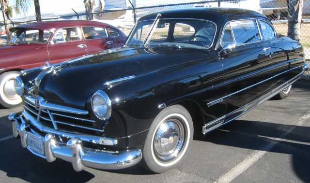

you could also get leather interiors - attached is a 504, original paint (black), and came with blue leather seats & naughyde door panels, headliner, etc.

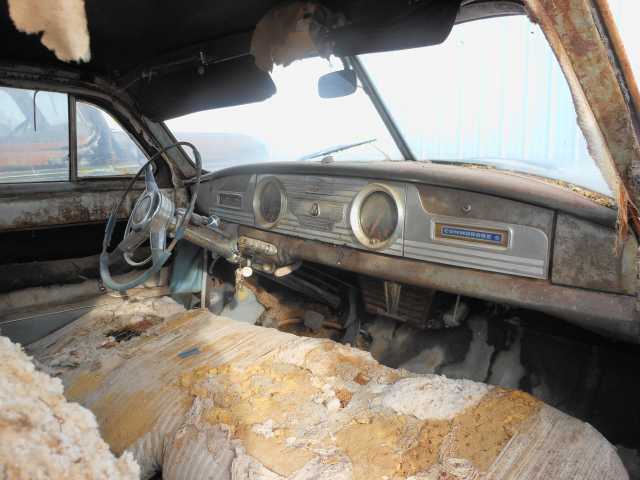

Do you have any more pictures of this 50 CCC? Especially the interior. I have one that I'm going to restore. The interior had door panels that had a diamond pattern. These all came with a blue or brown style interior for closed cars. The dash and other metal panels were brown-toned leather grain or a blue/gray tone leather grain.

this is the only other pic of it that shows the interior very well but I can take pics of just the interior if you'd like as he's my oldest HET crony here in town.

Thanks, appreciate that. Here's what I'm starting with.

I'm going to a little party with Buzz this aft. & will make an appt. to go to his house & photograph the interior extensively for you. Want me to post them in her or onto an e-mail to you????????

Pete, if he it's ok with it, post them here. Otherwise, let me know and I'll get you my edress in a PM.
