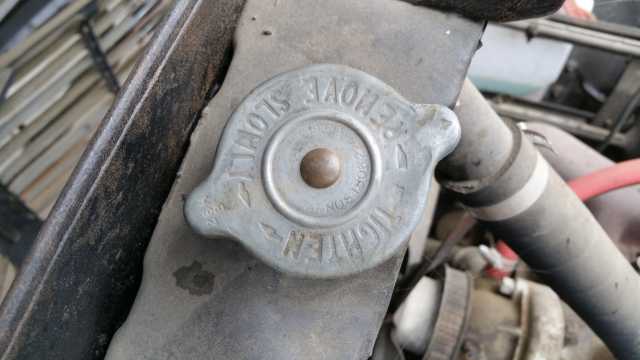

Since the '41 radiator has its overflow tube connected at the top of the radiator, not where the radiator cap is, any radiator cap that fits will work, whether or not it is supposed to be a pressure cap. It would be nice to find one that looks original, though.

Here is a picture of correct radiator cap. All my 41s have this type.

I so good to hear you you enjoyed the 41 Commodore you had. I may try to get in touch with Don to see if he would be interested in me buying a few parts from that car. I also want to thank you in sharing so much interest in my car. I could go on and on about it. The radiator cap I have now for it does look to have been on it for a long time. I have most always been fairly good at improvising but not on this 41, I want to get as much of the right parts as I can. It's not a matter of making it work like I have with so many things in my past. I know I don't have the only one but I still think it deserves to be done up right.
