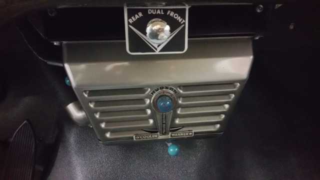

Alistair. Color matched heater box You can get an idea from mine. I'll take photos specifically of window surrounds if you like. I can get a paint formula for you if you;re interested. These were never woodgrained, but painted this solid color. Not sure exactly what they used for Chris Reiman;s Pacemaker, but ask him, he also has an opinion and I;m sure he researched it.

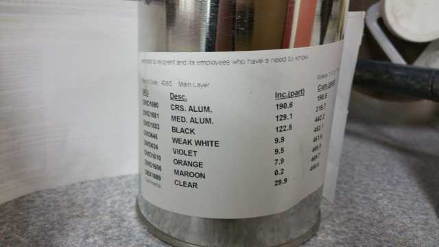

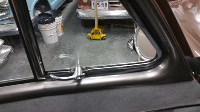

Alistar here are some pcitures. and the paint code.

one picture left out. The hand brake, steering column/shifter, garnish moldings, heater box were all painted this color. Is it exact? I don't know for sure. Did the best I could to come up with something close.

cross reference with Deltron 4385 in other words. Don't think this had any other special tinting.

That is great Tim, the photos are great, many thanks. I will check with my paint guy and see if he can recognise the code and will go from there. Will let you know.

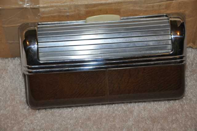

Dirk, I'm not positive, but think they were similar to commodore but teh dashes didn't have all the chrome trim etc on the Supers. For 1950, those items were 'leather" grained. Have done those, Hers's a picture from my 48 cadillac parts I did. We will be posting leather grain or the 51 Hornet soon and for 41 Hudson car woodgrain. Those came in 2 colors for 1950 Hudsons. Blue and gray leather grain and brown tone leather grain. Try taking off the glvoebox door, or a window garnish to look what the pattern is where it has been protected.
