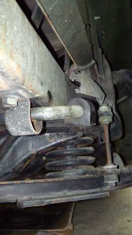

Here a picture of the busing that slipped out of position..
