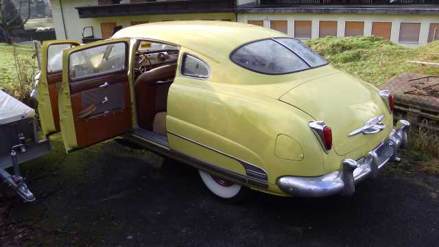

Two pictures attached. These were done after the car was unloaded from the truck.
Today I have moved the car from the outside position for some 50 miles to a dry car storage. That has been quite an experience. The first few miles on another continent for the car. And strange for me as I had to get accustomed to the sounds and behaviour of the car. The motor runs well, it was around freezing outside so it took a while not to stall away.
What was really new to me :
- when you drive and take the foot of the throttle - the motor reduces rpm, but there is no deceleration effect. I.e. I had to decelerate only with the breaks. It drives like a MTB-bicycle. When you pedal it accelerates, if you stop pedaling the bike keeps on rolling.
How do you get that setup to at least break to a certain extend with the revs of the motor?
What I also found out today is that most of the electrical elements do not work (break light, head lights, fuel indicator, horn). On the other hand I found a bulb hidden behind the inner ceiling above the wind screen that permanently burns. That has been the one killing already two battery loads.
I have now installed quick detachable battery clamps to disconnect the battery when not in use.
Another question:
left below the steeing column there is a pull button. what is that for ? I thought that is a choke...., Today I drove with the button pushed in.
Regarding manuals:
I have ordered the shop manuals on ebay - they are on the way.
Some pics from my Dodge - see both attached...
I also took some videos today - will follow!
Cheers
shorty
