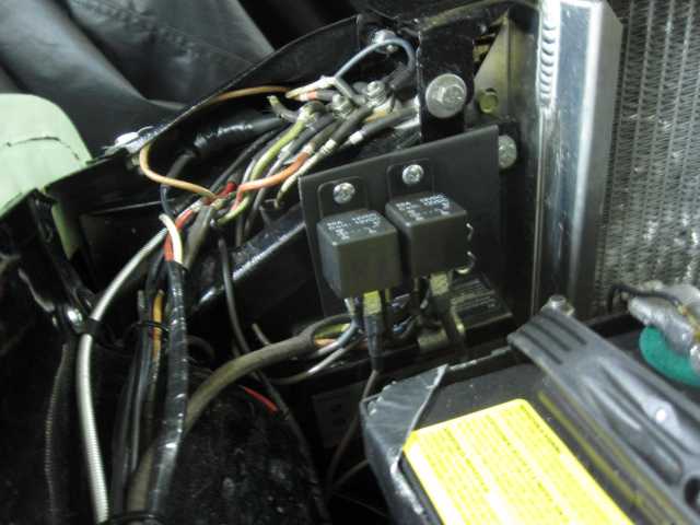

Below on my 12V-- 100 Watt H-4 beams {for stock, certainly hide relays}. Below relays is a Schaumburg battery minder or I would put the relays lower & one below the other on the support.

[quote="Richard Dryman" post=8724]Another 2 ยข: Consider two relays, one for low beam and one for high beam. If you are on a mountain road at night and a relay fails, you will wish you could hit the dimmer switch to keep the front seat clean !!
Even a circuit breaker can't reset fast enough. Don't ask how I know.
You are right, I do have two relays on mine I have mine mount on the radiator support in front of the battery. Don't fprget tp put a fuse in the main feed wire to each relay. A 14 Amp will be good enough.

Jim, I always overdo; I ran 2 #12 wires to + battery post with a fuse in each wire; use the minifuse in the molded holder. and also use heat shrink on every terminal. Don't like red-blue-yellow plastic showing with these connectors.
