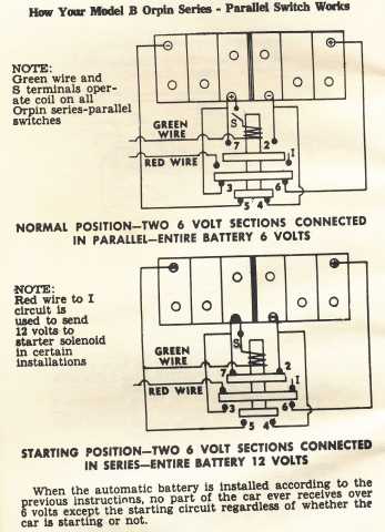

(@Richard Dryman)
I use an Orpin Model B series/parallel switch on my '31 Franklin. Starts on 12 Volts and runs on 6 volts; starter turns faster & I am happier~~~
Tricky little solenoid: follow the circuits
