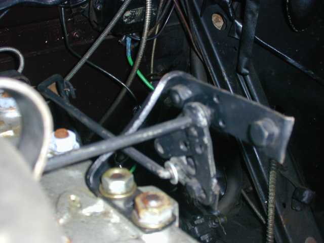

Question regarding the throttle linkage on a 1948 Commodore 8:
Please see the attached picture. What pulls the linkage arm that travels in the curved slot (on the right side of the engine) back to the neutral position? When I release the gas pedal, the throttle does not return completely to the idle position. Someone had wired something temporarily to fix this, and that wire broke. Am I missing a spring somewhere?
Thanks,
Josh

Looks like you're missing the torsion spring on the shaft at the top of your pic.

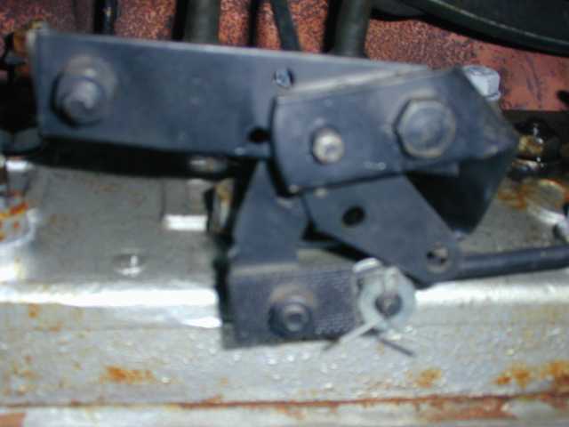

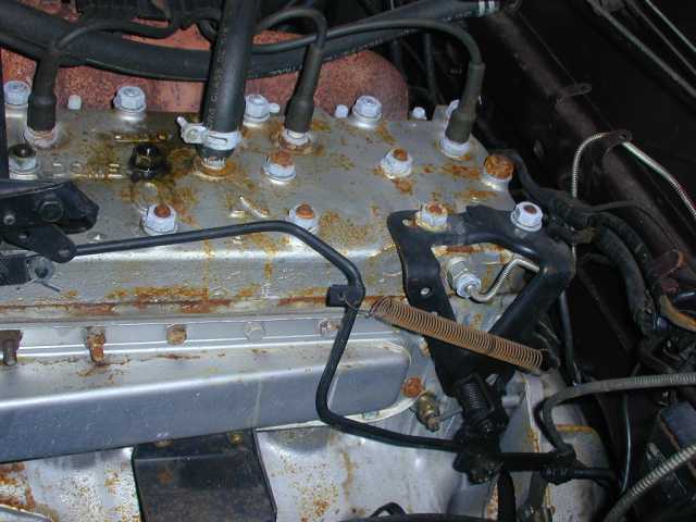

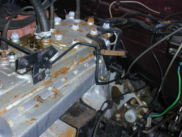

My 49 commodore 8 originally had Drive Master. Someone along the line deleted the DM. I have a pile of stuff on hand to re-install it. In the mean time, here are some pics of my throttle linkage that seems to work. hope it helps.

Many thanks for those photos! The linkage looks like a mixture of original and modified components. I see the upper spring that looks like it might have been added (shown clearly in the second photo). I have added a spring in this area, and it seems to be working.
