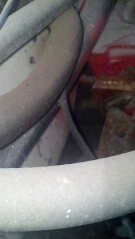

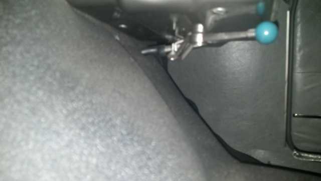

The car I could show you is my Pacemaker, but the engine and weather master fan are separated only by the floor board, so you can't see the tube on the engine side of firewall. here's an inside picture showing the drain tube. I'll go out and check my 54 after a bit.

Here are the pictures off my 1954 Hornet. Engine side is hard to see has it is right above bell housing in center of engine. But both inside and outside pictures show you that there should be a hold lined up with the bottom tray drain tube.

Thanks Tim those interior pics show exactly what I need to do. Appreciate. You taking the time to answer my question.
