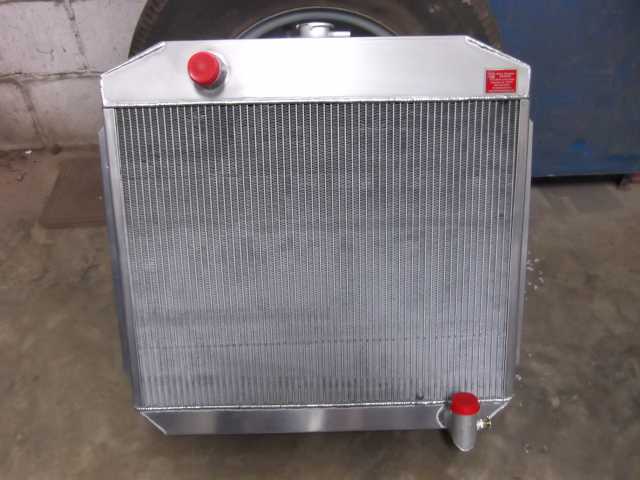

I sent CG&J a radiator from a 52 and they are made the print using a CAD file program.
they are building a new radiator for 545.00 with a high efficiency 2.75" core.

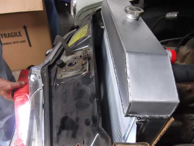

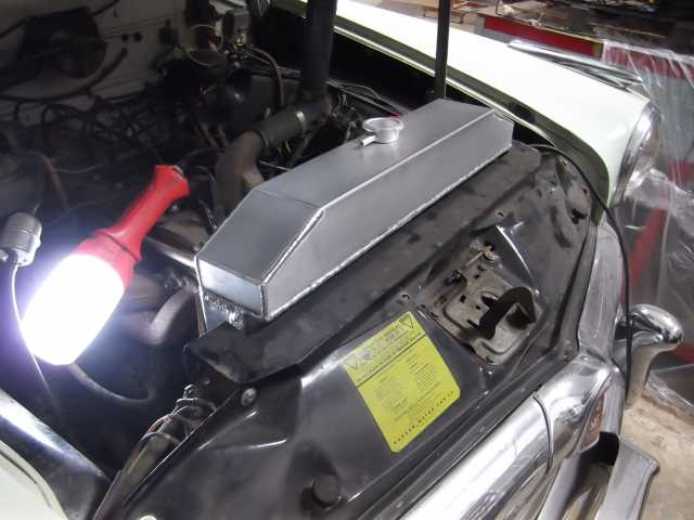

The radiator came in and looks very good.
Posted : 07/10/2014 2:38 am
(@Robert Aman)
Wow. Looks great. I think they can expect a lot of bidness from our club. I had a local guy re due a 49, my friend had and it was good for now. But the next one is going to be this guy. I am painting mine Black of course.

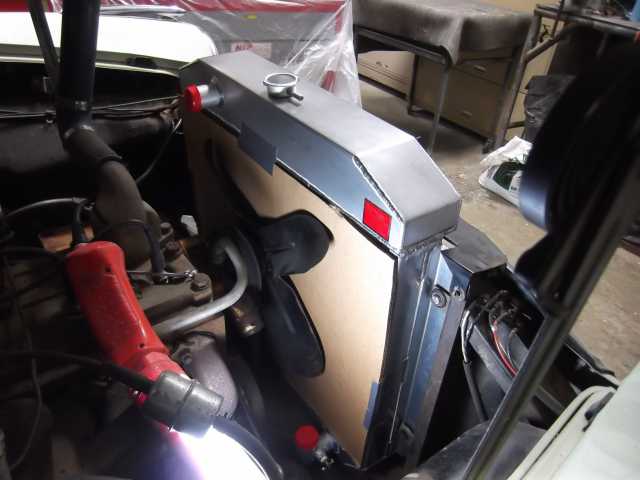

(@pfeifer)
Posts: 724
Prominent Member Registered
Richard, that is the plan. I was just doing a test fit.
The engine and tranny are coming out for a rebuild.
