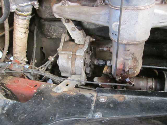

Cobbled alternator mount.....

Would you suggest, Ken, that a standard 6- or 12-volt generator might better fit in the bracket, and that the diameter of that (generator) would be less than that of the alternator? (Thus, the shaft would not be bent away from the engine block as it must be, now.)
Also, it looks as though a flexible coupling was not inserted between the extension shaft, and the shaft on the alternator. This could explain the problem they had with the timing gear, due to the stress that would have been caused to the shaft. The flexible coupling could be a short section of a rubber hose, held to both shafts with hose clamps....no?

The flexible rubber hose is how that era Essex (& Hudson?) were originally.

Am I seeing that right? Is the alternator mounted to both the frame AND the engine? If so, that's gotta go no matter what else you do.

Yep Frank you are seeing right! The distributor, generator and oil pump drive housing at the front of the motor fractured, and a piece came off. I suspect the oil pump drive was compromised when they cobbled it back together in Southern China, and then the rods and piston rings went out in Laos. They are now close to Thailand I think.

Does this car have rubber motor mounts? If yes, then the mounting of the alternator is likely to be causing a problem. However, if the engine is bolted right onto the frame, it is may not be causing a problem.

I think the forum members have offered some sensible ideas which could make the next portion of the trip less "eventful"! (For example: replacing the alternator with a generator which is correctly mounted, and which is attached by flexible coupling to the extension shaft. Also, allowing some time for the inspection of the remaining connecting rods, to verify that they are not becoming damaged.)

At the same time you order the rings to be shipped, you might want to order additional spare parts which might break, so that you will have them if you have further mechanical problems. Do you have ignition points? Wheel bearings? Perhaps you should obtain a generator which is closer in size to the original generator, to replace the alternator which is been improperly installed.
