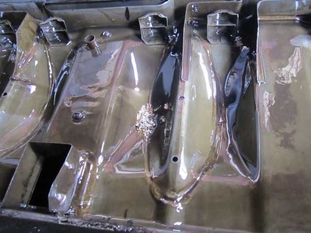

Can you tell us the exact problems you are having?
Have you contacted any Hudson experts in Australia or New Zealand? They may have the parts you need, and they are much closer than America.
Have you carefully inspected the "dipper tray" to make sure there are no holes in it, allowing the oil to drain to the oil pan below? If the oil has leaked from one of the six reservoirs, the bearing will fail.
Posted : 22/12/2014 4:15 am
(@adamb)
Posts: 320
Rod bearings failed. No holes in dipper tray. Looks like long duration high speed driving and lots of grades did them in .
