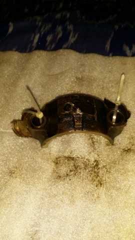

Yes, the oil dipper tube has broken off! It probably hit something in the engine. Did you find the broken dipper in the oil dipper tray (the upper oil pan)? That is surely the reason that your bearing has failed!
So, you cannot renew this connecting rod with new babbitt and re-install it. You must find another connecting rod to replace it.
The Hudson parts book says that all connecting rods from 1930 to 1937 should be usable in your engine. This will make it somewhat easier to find a good replacement, because rods from the later 1930's are easier to find. HOWEVER you must use a "right" or a "left" rod -- you must match exactly the rod you removed. ALSO the bearing size must fit the crankshaft journal. If your crankshaft has been machined to a smaller diameter, a "standard" sized rod bearing will no longer work. You will then need an undersized bearing, which should be available. You must measure the crankshaft for the exact size.
In an emergency, I believe it may be possible to continue on your trip with 7 cylinders working, but you must remove the "bad" rod and piston. You would also want to stop the petrol from entering the "bad" cylinder, so that you do not dilute the engine oil with petrol coming from the carburetor. I think that when you remove the piston, there will be no vacuum pulling the gasoline into the cylinder through the valves, but I have never attempted to do this. So I do not know!

Attached you will find a pic from the "journal"?? sorry about my spelling don't know all the terms
maybe that helps you to help us.
