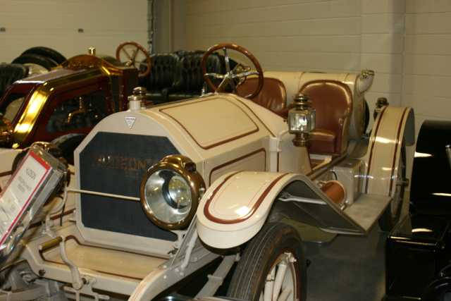

Fred, I guess the first question is if your 33 is one of the "Mile a Minute" Roadsters. The best way to tell is if the floor on your car has two levels on it. This was only on the Mile a Minute roadsters. Here is some photos of the one in Salt Lake city that I took today.

This 1912 Mile-a-Minute roadster is in Salt Lake City, Utah in the private collection of John Price. John has a collection of racing cars (including the Mormon Meter) that numbers around 30. The display plaque reads that it is one of two known to exist. This tan car is originally from New York and was purchased and restored by Eli Williams in the early 70's. Eli also purchased and restored one in the gray colors and later sold the car to a gentleman from California. It was originally from Washington.

Fred, When our Utah Chapter visited the John Price Racing Car Collection (Google this name and see what he has posted)this past Saturday the folks there were very protective of the collection and limited us quite a bit on what we could see and photograph. The photos that I took were all from in front of the car and all the cars were about a foot apart from the next car. The fellow who runs the collection is a long time friend of mine and in speaking with him I mentioned that I would like to take some photos to use for an article for our WTN. Long story short, If he can obtain permission from the owner, I will return this next week and we will take the car out for some photos. I plan to shoot a ton, but is there anything I should be capturing to help you with your project?
