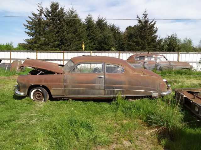

No, I haven't. It's all still in there. The critters have made nesting material out of all the wiring so it's all bare. I am going to have to replace from tail light to headlight. If I was smarter I would probably buy a restored car and be money ahead. But this car called out to me and I have to save it. I think I might go with YnZ, they sent me some pretty good info with a decent price. And, as some forum members have pointed out, someday, this car will be passed along to a new owner.

Im probably going to build a new bottom for my door or I am toying with the idea of sectioning the bottom of a sedan door I think I can lay my hands on. ive got a little rust in my hood too. I will either use a little lead there or if I have to I will cut it out and stitch in a patch.

Posts: 429
Hi Steve,
It is great that you are saving the car! It looks solid. I like coupes.
