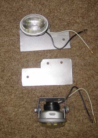

SOLVED: backing up 'blindfolded' at night !!! Stock or basically any kind of back-up lights do not adapt to the later step-downs. This is a fantastic solution. These are 2" diameter 55 watt driving lights sold by O'Reilly's; haven't found them at another place yet. With 12 volt H3 bulbs when bought but 6 volt H3 bulbs are available.
Look at this and think about it. I haven't finished wiring yet; will try to use a lever brake light switch or a neutral start lever switch on the linkage. A lighted manual switch comes with item.
Suggest relay & #12 wire.
An EXCELLENT appearance at the rear !!!

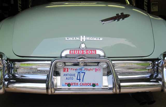

PROJECT COMPLETE !!! For a 'wrap': the auto neutral switch has 2 extra male connectors that have continuity with selector in reverse. So, connect 'switched' power to one and connect the other to #86 on a relay; #30 & #87 are the power connections to the relay. Use #12 wire back to the back up lights; ground lights to bumper/body.

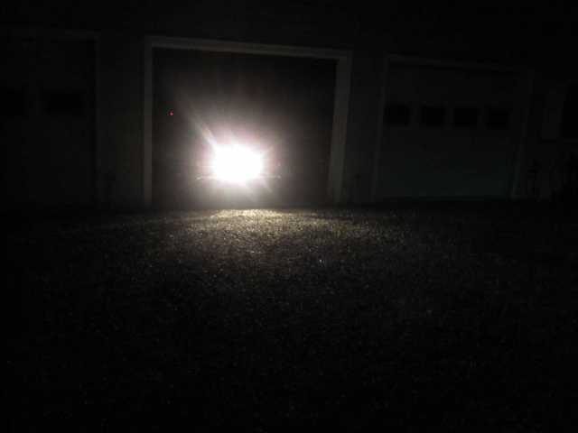

They are extremely bright; basically LEGAL 55 watt driving lights. Photo below was taken with engine NOT running--volts would have been 14.5+ then and lights would have been brighter. You will get the idea tho. This has been a good project with the Hornet. Sorely needed if you drive at night; I don't much but now I CAN ~~~~~~~
