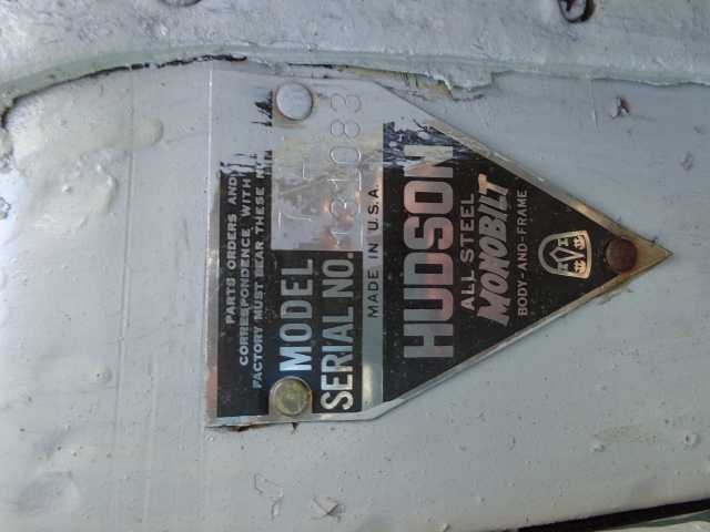

Hello, my name is erik
from holland, own a hudson hornet 1951 hollywood coupe
Can somebody help me with the Original colors, that goes with the vincode 7A 131083?
The car is oversprayed with another hudson color, but i like to restore it to the Original.
any help appreciate!
thanks Erik

Has the trunk area been re-sprayed as well? I don't think you can use the Hudson vin to determine color like you canon later cars. If you have to, you can pull the vin tag off (held in place by the three "screw" type tacs or nails) and see what color is under the tag.
It looks like the door area rubber seals were painted over as well. Lift up one and see if you can see the original color. Wildricks carries new rubber seals.

I think the code may be stamped on the upper passenger side hinge, front door. 1 letter if one color, or 2 if two-tone. You may have to get out a wire brush and work at it to be able to see it. Of course, if you start taking the newer paint off, you'll see how many layers and repaints there have been and can get an idea of the original color. Look here for paint codes:
http://www.hudsonterraplane.com/tech/1951/1951CarDistributionDepartmentBulletins.pdf

Tim has it right, I had forgot about the door hinge stamping.

Also, Erik, you can get a new serial number tag from the club store to replace yours which has wear and primer on it.

hi kerry, thank you,
yes i found 73, that looks like the two tone grey blue colors...
I do not want to loosen the tag because i got in big problems to get through our DMV in Holland,....after that inspection and licence check, i can remove and put it back..

i guess youre could be right, the paint on the cowl...looks like that Cornish cream, but they repaint it with grey blue...
I checked the code its look like 73 or 78 color code..

Walt here, 73 is French Gray, Lacquer # 2618-- Synite# S-6792 If there is another number give it to me and I can tell you the combination, which is lower or upper. I have all the factory color combination for 1942 to 1952.
