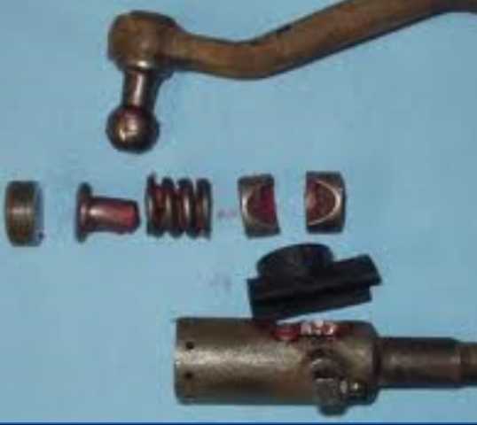

(@Richard Dryman)
slop typically occurs on the ends(both) of the drag link. Take large screwdriver and completely tighten(screw is on left side below). Wonder if any of these internal parts are available?
Posted : 02/08/2014 6:39 am
(@Mike Sheridan)
Also look for wear on the ball. It might not be round any more due to failure to lubricate it over the decades.
Posted : 02/08/2014 9:10 am
